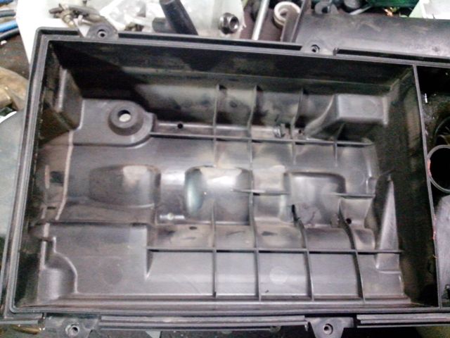

I do not known if it have been already shown around here...

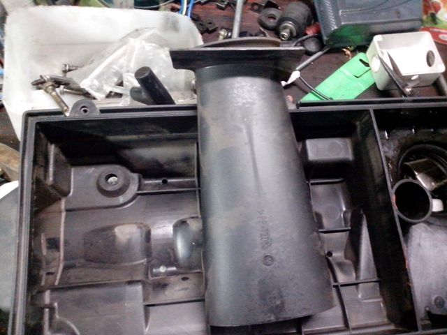

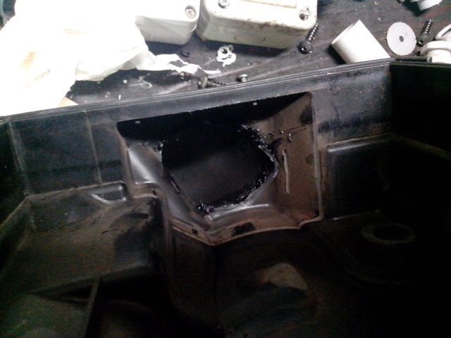

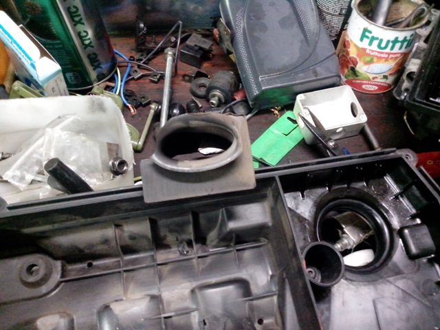

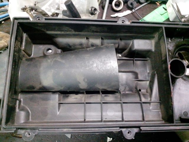

but here there some pictures that i have made of the mods on the standard air box of polo AFH 16v 6n1
the original air box with snorkel

after this mods the car run very well on high revs and seems to havn't loose nothing on low revw...
sorry if i write in english... but i think my german is really bad...
do you know the "sorg motorsport" modification on the standard air box?
no, i do not know sorg motorsport modifications...
but it seems like mine ... i have to make the stack velocity seen on pics sorg2.jpg
i have use a sport air filter and some old motorbike air box pipe that i have around my garage for making the fresh air incoming line...

Der Sorg Trichter macht leider wenig sinn da er einfach zu klein im Durchmesser ist.
